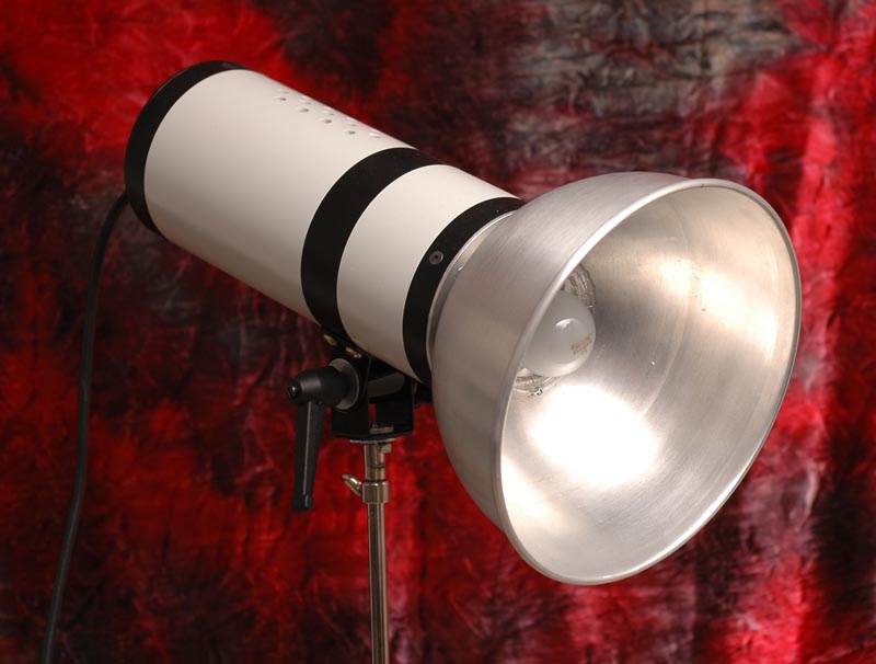

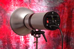

This monolight is intended as a complementary flash unit to be used together with a more powerful flash system. It will be used primarily as an accent or background light. The flash energy and recycling times were selected to modest values.

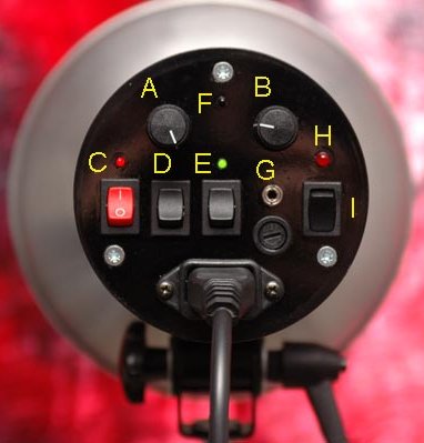

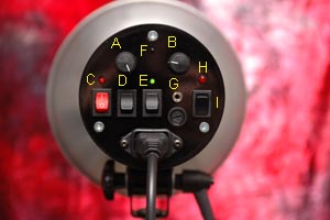

The unit is housed in an enclosure fashioned from 110mm plastic drainpipe tubing, and homemade aluminium parts. All controls are on the back panel, and the housing has holes on the top and bottom for cooling. The reflector shown in this picture was fashioned from a regular lamp fixture (IKEA).
The flash tube is from the european electronics distributor Conrad. It has a low price and is rated for 500Ws. The modelling light is a small 40W E27 bulb. This low wattage was chosen in order to maintain proportionality with more powerful units.
