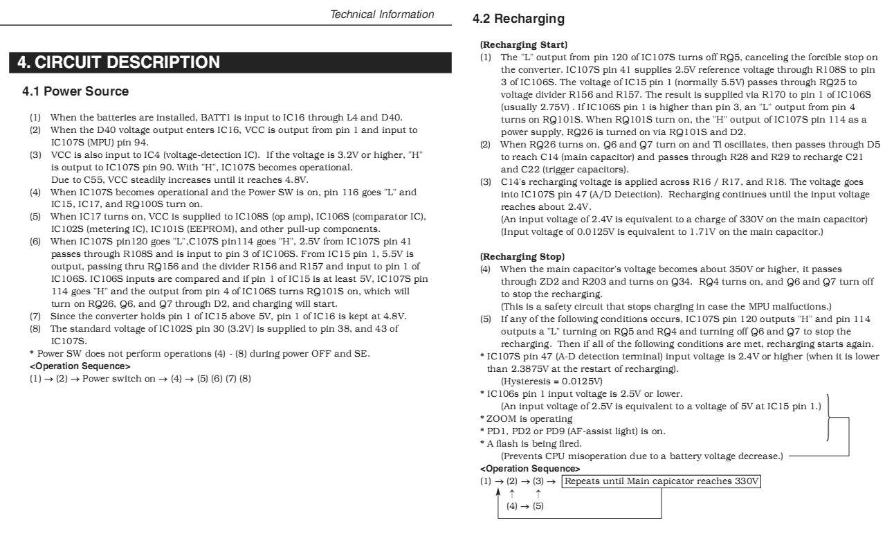

4. CIRCUIT DESCRIPTION
4.1 Power Source
(1) When the batteries are installed. BATT1 is input to IC16 through L4 and D40.
(2) When the D40 voltage output enters IC16. VCC is output from pin 1 and input to
    IC107S (MPU) pin 94.
(3) VCC is also input to IC4 (voltage-detection IC). If the voltage is 3.2V or higher, "H"
    is output to IC107S pin 90. With "H", IC107S becomes operational.
    Due to C55, VCC steadily increases until it reaches 4.8V.
(4) When IC107S becomes operational and the Power SW is on. pin 116 goes "L" and
    IC15, IC17, and RQ100S turn on.
(5) When IC17 turns on. VCC is supplied to IC108S (op amp). IC106S (comparator IC),
    IC102S (metering IC). IC101S (EEPROM). and other pull-up components.
(6) When IC107S pin 120 goes "L”,  IC107S pin 114 goes "H", 2.5V from IC107S pin 41
    passes through R108S and is input to pin 3 of IC106S. From IC15 pin 1. 5.5V is
    output, passing thru RQ156 and the divider R156 and R157 and input to pin 1 of
    IC106S. IC106S inputs are compared and if pin 1 of IC15 is at least 5V, IC107S pin
    114 goes "H" and the output from pin 4 of IC106S turns RQ101S on, which will
    turn on RQ26, Q6, and Q7 through D2, and charging will start.
(7) Since the converter holds pin 1 of IC15 above 5V, pin 1 of IC16 is kept at 4.8V.
(8) The standard voltage of IC102S pin 30 (3.2V) is supplied to pin 38, and 43 of
    IC107S.
*Power SW does not perform operations (4) - (8) during power OFF and SE.
<Operation Sequence>
((1) -> (2) -> Power switch on -> (4) -> (5) (6) (7) (8)
4.2 Recharging
(Recharging Start)
(1) The "L" output from pin 120 of IС107S turns off RQ5, canceling the forcible stop on
    the converter. IC107S pin 41 supplies 2.5V reference voltage through R108S to pin
    3 of IC106S. The voltage of IC15 pin 1 (normally 5.5V) passes through RQ25 to
    voltage divider R156 and R157. The result is supplied via R170 to pin 1 of IC106S
    (usually 2.75V). If IC106S pin 1 is higher than pin 3, an "L" output from pin 4
    turns on RQ101S. When RQ101S turn on, the "H" output of IC107S pin 114 as a
    power supply, RQ26 is turned on via RQ101S and D2.
(2) When RQ26 turns on, Q6 and Q7 turn on and T1 oscillates, then passes through D5
    to reach C14 (main capacitor) and passes through R28 and R29 to recharge C21
    and C22 (trigger capacitors).
(3) C14's recharging voltage is applied across R16 / R17, and R18. The voltage goes
    into IC107S pin 47 (A/D Detection). Recharging continues until the input voltage
    reaches about 2.4V.
    (An input voltage of 2.4V is equivalent to a charge of 330V on the main capacitor)
    (Input voltage of 0.0125V is equivalent to 1.71V on the main capacitor.)
(Recharging Stop)
(4) When the main capacitor's voltage becomes about 350V or higher, it passes
    through ZD2 and R203 and turns on Q34. RQ4 turns on, and Q6 and Q7 turn off
    to stop the recharging.
    (This is a safety circuit that stops charging in case the MPU malfuctlons.)
(5) If any of the following conditions occurs, IC107S pin 120 outputs "H" and pin 114
    outputs a "L" turning on RQ5 and RQ4 and turning off Q6 and Q7 to stop the
    recharging. Then if all of the following conditions are met, recharging starts again.
* IC107S pin 47 (A-D detection terminal) input voltage is 2.4V or higher (when it is lower
    than 2.3875V at the restart of recharging).
    (Hysteresis = 0.012 5V)
* IC106s pin 1 input voltage is 2.5V or lower.                                  |
    (An input voltage of 2.5V is equivalent to a voltage of 5V at IC15 pin 1.)  |
* ZOOM is operating                                                             |
* PD1, PD2 or PD9 (AF-assist light) is on.				        |
* A flash is being fired.                                                       |
(Prevents CPU misoperation due to a battery voltage decrease.) -----------------
(1) -> (2) -> (3) -> Repeats until Main capacitor reaches 330V
       (4) -> (5)

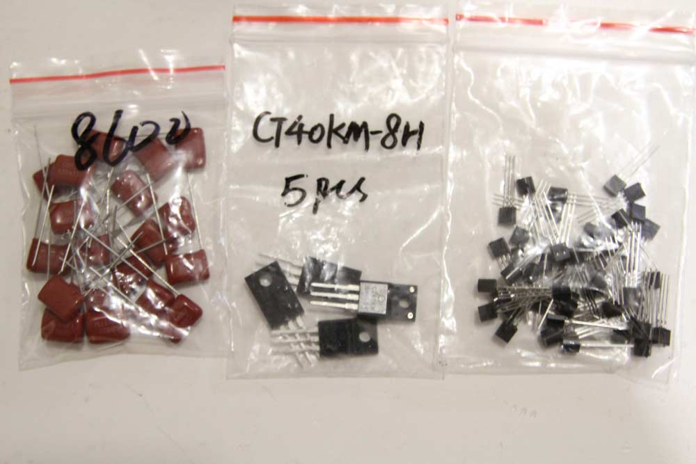

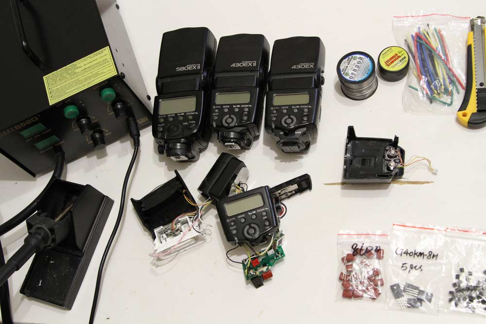

430 включается, заряжается, но вспышка не срабатывает (pilot горит красным). Проблема с поджигом.
Прочитал тему.
При включении на лампу идет напряжение. IGBT пробит, замыкание между эмиттером и коллектором.
Приобрел CT40KM, в довесок сразу взял MCR100-6 и конденсатор 47 nF. Заменял все по порядку и пробовал. Результата нет.
В наличии есть еще одна 430, 430 II и 570 II. Все рабочие, если они как-то помогут с диагностикой...

Вижу, что вы не случайный тут человек. Паяльная станция это все же показатель (хоть и косвенный) некоего уровня специализации. Поэтому я пока не стану комментировать касательно диагностики, прикрою свой фонтан, может тут еще кто-то пожелает высказаться. У меня сейчас вопрос к вам как специалисту: тема, конечно, разрослась и "воды" в ней много, но вы, видимо, ответа не нашли в ней, верно? И второе, что вы можете назвать к качестве причины наблюдаемых симптомов, исходя из вашего анализа схемы и сервис-мануала вспышки Canon 430EX? Есть у вас какие-то предположения?
И ещё один вопрос: какое напряжение на основном конденсаторе? Так сказать, First Rule of debugging: "Measure voltages first".
У меня к вам будет просьба: пожалуйста, попытайтесь сделать снимок импульсной лампы во время попыток её поджига. В затемнённой мастерской бывает видно, что в трубке проскакивает искра. Или этой искры вообще нет. Синхронизировать камеру и вспышку удобно или по проводам, через Off-Camera TTL Flash Cord, или с помощью радиосинхронизатора.
Вид стримера в лампе, его наличие или отсутствие - это один из симптомов и давно уже жду, пока кто-нибудь такие снимки выложит. Вот здесь есть примеры, но неудачные в фотографическом смысле, да и другая вспышка, вроде бы Sigma, viewtopic.php?p=23535#p23535
